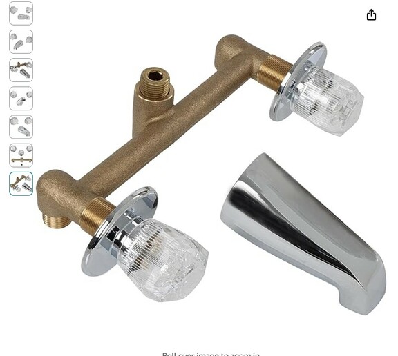

john in la
08-13-2023 19:48:34
Report to Moderator
 Re: Plumbing question in reply to Ultradog MN, 08-13-2023 19:03:46
Thanks Jerry
I was hoping you would see this post as I know you do bath remodels.
mandated all shower valves have a balancing/anti scald function
Even in two handle faucets ????
not done in the shower head but in the size of the ports in the valve itself
So you saying I should be looking for a tub valve and just divert the hose up to the shower head instead of a tub spout. Then I can just worry about the flow rate of the shower head.
Third Party Image

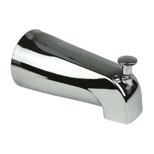

Ultradog MN
08-14-2023 02:50:26
Report to Moderator
 Re: Plumbing question in reply to john in la, 08-13-2023 19:48:34
Sorry,
It has been so long since I installed a two handle faucet that I kinda forget about them.
The two handle valves do not have the balancing function. But they did restruct the flow.
Are we working on a tub? A tub with shower? Or just a stand up shower ie no tub?
Most valves will have an outlet on both top and bottom. I can't tell from the photo if that has the bottom outlet. If you want it for tub with shower you need to use a spout with the diverter valve.
Third Party Image

john in la
08-14-2023 04:57:07
Report to Moderator
 Re: Plumbing question in reply to Ultradog MN, 08-14-2023 02:50:26
I am replacing a tub only with a stand up shower with a seat in it. So it will be a shower only.
The picture is just a quick look on internet.
The existing valve on the tub it 3 pieces. 2 valves and a tub spout. They are connected by hoses not the brass fittings in the picture. It has good flow. I could use similar and just run the hoses to the shower head.
Im thinking a tub valve doesnt restrict water flow because it is not like a shower or kitchen sink where you run it for an extended time. Plus with restrictions it would take forever to fill the tub.
I was looking on the net last night and it seems pretty easy to bypass the shower head restriction.
