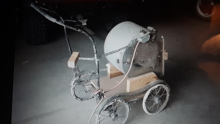

How do you keep it from running away. The blower I have moves just screwed to a sheet of plywood.

The baby carriage has rear brakes.

First furnace blower I reused, I forgot some of the heat and air stuff I knew. Rigged it up to help clear fumes from the shop. Seemed to work so I left it running while I went to lunch. When returning from eating, the smell was bad, overheated windings. The intake had to be restricted to reduce the load on the motor.

I reduce current by restricting discharge. You may see a piece of wood. I adjusted the opening for minimum current. I used an amprobe.

What is the purpose of the wood block attached to the end of the pipe hanger?

To adjust the angle of the fan.
Down to blow the dirt on the floor out the door. Up to blow the air on me.
