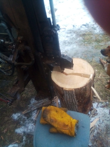

I built mine to mount on the 3 point hitch of my Kubota B7200. Transported it horizontal and crossways to the tractor. When up in the vertical position I would sit on a stump next to the right rear wheel. Ran off the hydraulics for the loader with a detent valve bolted to the ram. Wasn't fast but didn't stop.

I find it easier for me to sit down and split wood.
If I can roll the blocks to splitter I am in business, no lifting except to tip up.
You do need a large working table for wood to rotate on easily,
