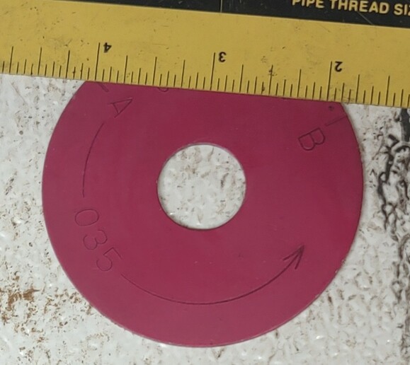

The other side of the tool
Guido. Third Party Image

timing disc??

DaleinWV,
NOT a timer but a gauge to set the engine brake on a Caterpillar engine.
A to B adjusting screw sets the activating solenoid to . 035,
Guido.
