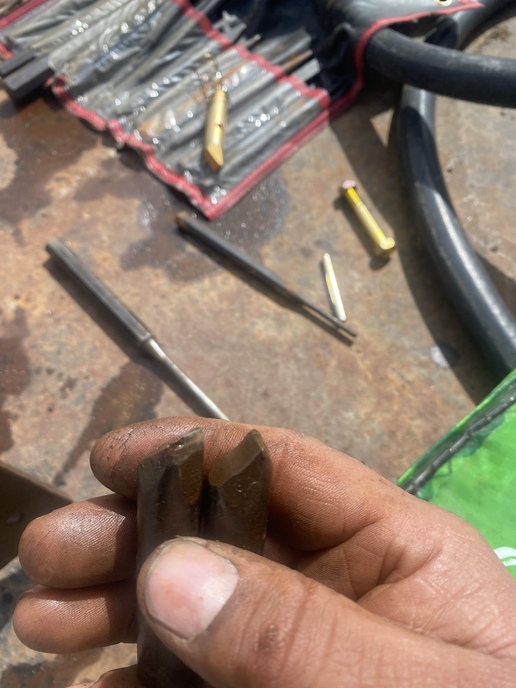

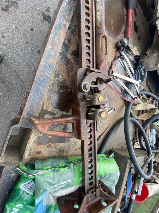

Handyman Jack been using these for 30 years now and finally decided I would try putting new pins and spring in one found the kit locally . New Jack was 100$ rebuild kit was 22$ had to buy a bushing for the leaver and a package of them was 3$ . A good wash down with some penetrating oil works like new . Third Party Image

turn the mast upside down when the holes get worn

Ill try that . The holes on mine are ok but the climbing pins and springs get wore out

They are good but you always have pay attention make sure the pins are both all the way in so they both hold the load keep them oiled so the pins move freely be careful what you lift so that it doesnt fall sideways
