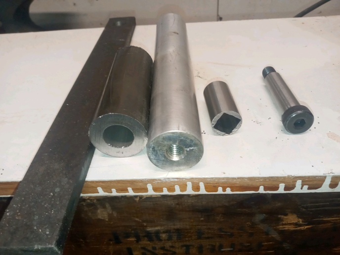

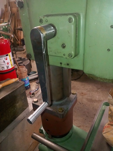

My project today
Ultradog MN
Well-known Member
Location
Twin Cities
I used these pieces,
to make this crank,
to raise and lower the head on my drill
press.

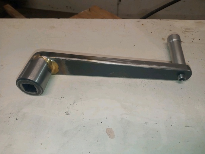

TIG would probably look nicer (I like your braze job) but the brass pulled into that butt seam is stronger than an outside TIG weld, unless you chamfered it out and filled it back up with weld. I would have chamfered it out and MIGed it together - and my TIG is setting right beside the MIG, all gassed up and ready to weld. steve
Stevieb and Janicholson,
The square bushing is just a light press fit into the outer tube. So I champhered the outer tube back so the braze would tie the outer tube, the square bushing And the handle together - like a 100% penetration weld.
I would have done the same with what ever method I used.

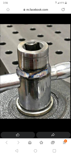

I'm sure this is strong but tig welding is such a precise way to join or fill small parts without all the excess heat from brazing. And it just looks cool.
Not that I could make welds like these I grabbed off the net but it would be fun to practice...
