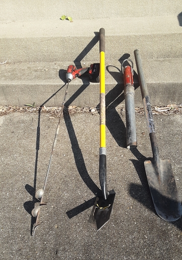

I used the shovel I made out of a spade and a steel post driver.
Shovel on the right is the new shovel.

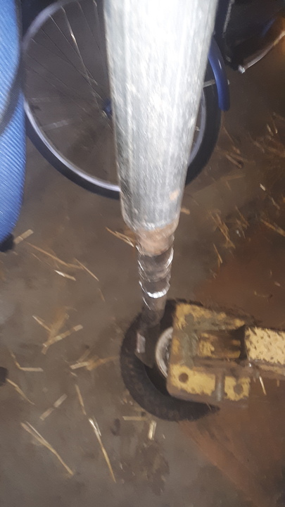

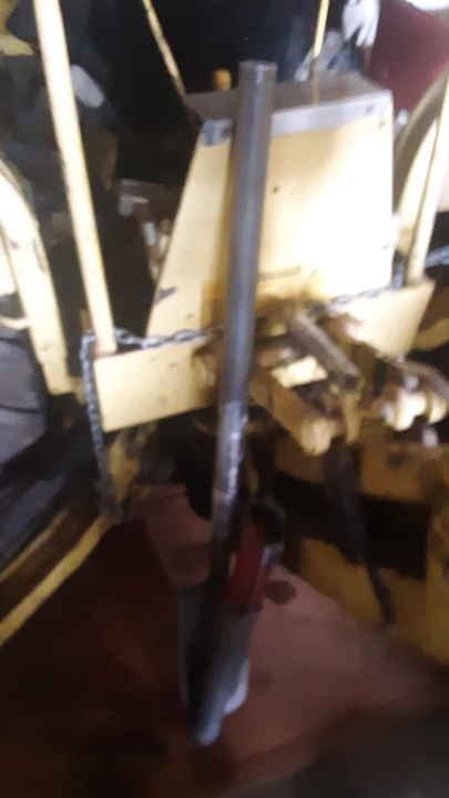

Used outrigger to hold the tire in place.
Third lick and mission accomplished.

I have been thinking about attaching something round to my
outrigger.
The only thing I have with a brake drum is my 2007 GMC rear
brakes.
Thanks for the idea of using a brake drum.
Now I have something to look for.
