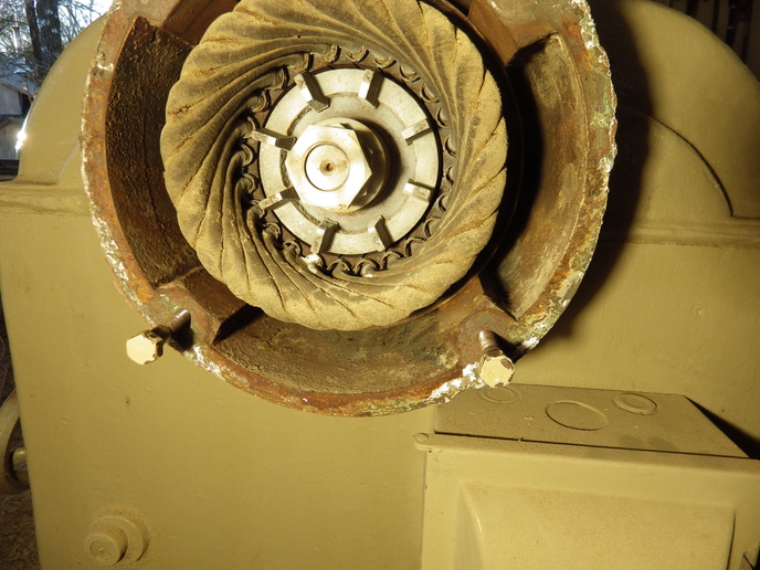

Do you think this motor could be removed from this machine and worked on without the outer shell. Otherwise I have 2 tons of electric motor to take to a repair shop.
It tripped a breaker a couple times and then just won't come on anymore. There is two motors in the machine and the other one works fine so there is power there. I tested the switch and it's working alright so I don't know what else to do.
That's over my head to check some of that. I did check to see if there was 220V between the leads and there was. The planer has this motor which does the cutting and a separate motor which feeds the wood and the feed motor is still working.
Depends if you want to go to all the work and expense of re-winding the motor . Just to find out that a cable or the breaker has failed instead of the motor .

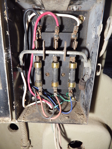

Steve, how about a good, clear, picture of the inside of that box.
It may have fuses in it for that motor.
If there is only one power cable to the machine, the power has to be split somewhere to go to the two motors.
The two motors are probably different horsepower and are fused separately.
Yes, it does have fuses. That is the first thing I checked and none of them are burnt. The two motors are not fused separately the leads go to the magnetic switches on the same lines. I checked the wires there and none of them are loose or burnt. The connection at the cutter motor I haven't checked yet. Much of the machine would need to be dissembled to get to that.
My first thought would be to check if something is preventing the machine from turning.
Something jammed or a seized bearing.
Next would be a thorough check of the electrical supply and wiring of the unit.

I'm pretty sure you can pull the rotor and then unbolt/remove the field. A motor shop can then perform the above suggested tests.
The whole rotor shaft will likely have to be removed, which may be a challenge to say the least. Then bearing conditions can be analyzed.
UPdate, the motor is alright. The problem was with the magnetic switch. I worked it manually and the motor ran. Now I just have to find a replacement switch.
Did you check voltage across the coil?
It could be the coil, but it could also be the overload tripped or a stop station not closing, or any number of failed connections.

Did you check the over load on the starter, push the reset button?
The coil on the magnet could be bad.

This is the culprit. After I manually started it, it has continued to run however I know the condition will get worse. Bad thing is I was needing to surface some wood yesterday to get a deck put in before the weather turned bad at the end of the week.

You can replace the offending magnetic switch yourself, no harder than disconnecting all the wires to take it to a shop!
You MAY be able to find an exact replacement contactor on ebay in good used or "New Old Stock" condition, and there are ALL SORTS of brand new modern contactors on ebay, Amazon, etc. that you could replace it with. Once you select a modern contactor in the rewuired HP range it can be "dialed in" to the running current of the motor, etc. with little switches, no need to get the exact "heaters" to match you motor as had to be done in the past.

It's an old woodworking planer. The problem I was having was the motor on the top that powers the cutter quit working. What scared me was the shaft for the motor was also the cutter head and it went all the way through the machine and the motor. The machine is somewhere around 90 years old so I'm sure everything is thoroughly rusted in. Very thankful I don't have to take the motor out.

I used to replace a lot of contactors, sometimes on some pretty old stuff. I got them from Graingers and paid a lot less than OEM. It isn't hard to go to their charts and pick out one that has the specs that you need. looking alike is not important. When trouble shooting electric don't condemn something like that motor that isn't working until you verify that it actually has current to it.

Breakers trip on heat. Take a switch rated for a certain current and you have a cross sectional area designed to tolerate the current-resistance of the contact-temperature for the desired rating. Use the switch-contactor for a period of time especially with inductive, motor, or lamp loads and the material on the contacts migrates'burns off/welds to the other contact....on and on....net result is reduced contact area meaning Ohms law gets the contacts hot and the switch thinks it's in an overload condition...which it is under the circumstances and it trips.
Burnishing (sanding) the contacts working down to 1000 grit range paper could solve your problem if it's the contactor.
