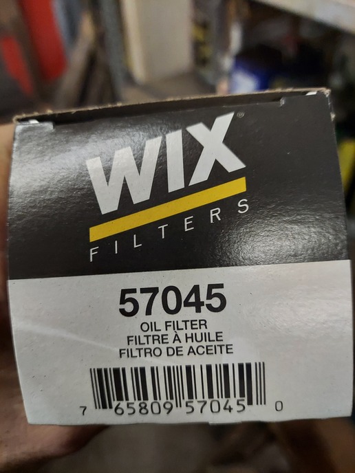

I bought my 2013 GMC Sierra 1/2 Ton, 2WD with 5.3 engine new in 2013, and the oil pressure gauge showed low readings from day one. When it was cold it would show less than 40 psi, and after warm-up it was down around 30. I have 35K miles on it now, and oil pressure readings are probably 30 psi at best. The factory gauge doesn't show numbers, so I'm guessing. I'm hoping the O-ring on the pickup tube is the problem. Replacing it would be easier than replacing the pump, but I'll probably hire it done. Does anybody have experience in comparing the cost of this job to doing the oil pump replacement at the same time?

https://www.wixfilters.com/Lookup/PartApplications.aspx?Part=57045XP

Use a WIX 7045 and your pressure will increase. The oil pickup o'ring is an old wives tale with the 5.3. They did have some issues pinching that ring on assembly in 1999, never seen it since. I've been around the LS engine since the beginning, worked at a GM dealer then.

The number has me confused, Sprint. I ordered two Wix 57045XP from Amazon, and I hope I didn't make a mistake. All the Wix charts call for Wix 57060 on this pickup. Will the 57045 work?

57045 is a longer oil filter than original. It will fit fine, and presumably will have more filter media in it. I use them on my 5.3 and 6.0.

Thanks, I'll order one of those filters.
