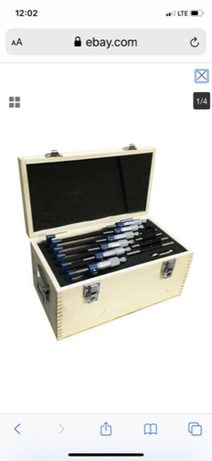

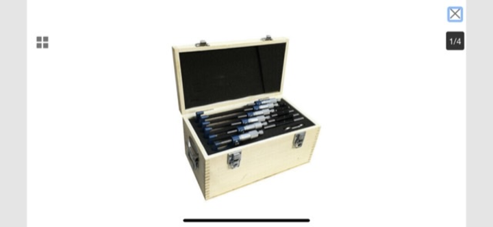

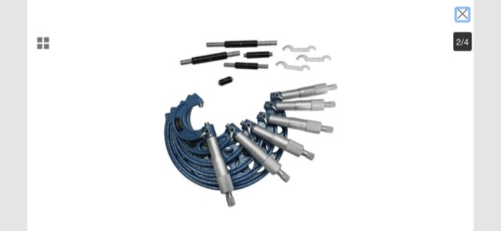

Bought a cheap set zero to six inch micrometers to have around the engine shop .

I bought the same type of 0-12". I don't need to read tenths for what I need them for, .001 is good enough. When I checked them with a set of known standards they were spot on. Just so you know there is a finger pad in the middle of the arch for a reason. Makes little difference how you hold a 0-1 or 1-2 but you get into the bigger sizes the heat from your hand will make for surprisingly large errors.

Just run the standards against a known true set in town.

I agree. No micrometer is permanently accurate. They need to be checked on a standard and adjusted on occasion. A cheap mic just needs it more often.
For most guys who don't use them every day +/- .001 is about the best they can do with even the best mic anyway.
SV, always use the ratchet to tighten the mic down. Two clicks. It takes an experienced hand to do it with thumb and finger on the barrel of the mic.

I bought an inexpensive Chinese set some years back for the same purpose. I checked the standards against a good set (Starret IIRC) of a local business and the standards were pretty close to dead on. I just make sure the mic is good on the standard and use them carefully. Using a mic is all about consistency and feel anyway.

A few years back I was at a automotive swap meet, I guy had a Starret set with the changeable anvils 0 to 6" for $100.00 . I didn't haggle just gave him a $100.00 bill. I use it to measure pistons and set the bore gauge. I recently purchased a set like shown above, it seems to be a good value. Would be better then using a set of calipers. The set comes with gauges and you can set to zero. It cost exactly the same $100.00. I will probably still use the Starret, something about getting it out of the oak box and setting the anvil is satisfyingly.
