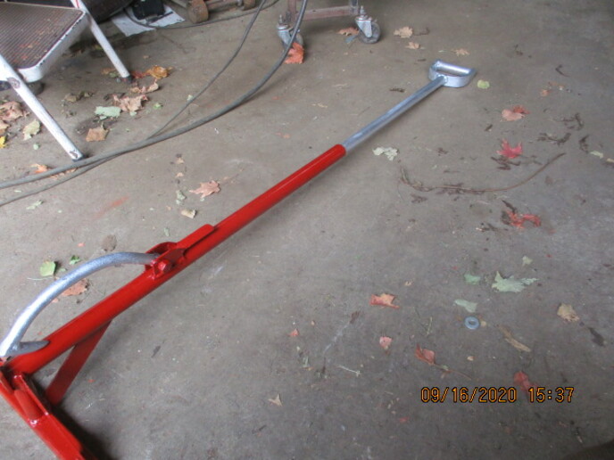

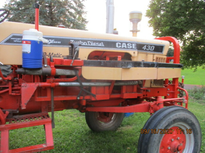

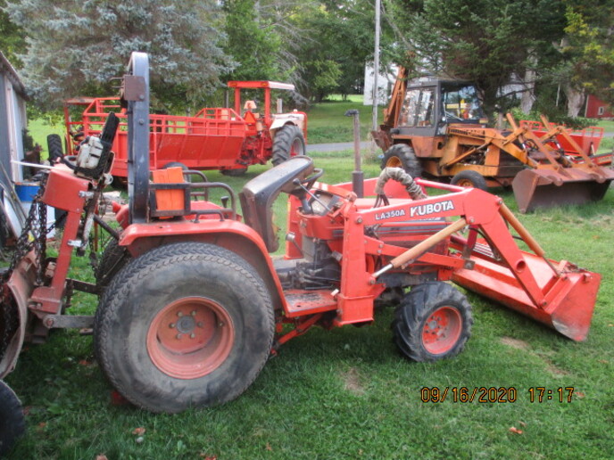

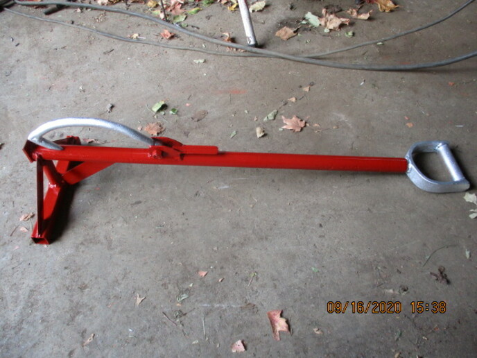

I had a couple of hours idle time so I fabed up another log lifter from bits and pieces. It has a telescoping handle, so easy to mount and carry on my 3pt skidding arch and has enough leverage to roll big logs. made it from old rusty 1" pipe, 5/8" rod for bail, and 1" OD tubing and some other small scraps. I bought one back in 70s from Northern Tools but it is mounted in it's bracket on my firewood processor tractor. I needed one for my skidder tractor also, because I found it more productive, sometimes, to block firewood logs as I skid them to the landings, and this one will be mounted on the 3pt arch when I do block individual logs.
Very nice ! I found a NOS Peavey Timber Jack on CL some years back. Absolutely a must have tool for blocking. They have some nice tools, they kind of remind me of Union Fork & Hoe. I'd like to get a pair of pulp hooks, still not sure which ones, thinking the one with a replaceable tip. The other tools would be a pair of the appropriate length Pickaroons and a Bark Spud. Another favorite of mine is the Lockhart log gripper from Bailey's, green one for 16" to 18" blocks, I have one, works very well. These simple tools make handling logs and firewood so much easier. I'd need a similar arrangement like you have to process in the woods, instead I just carry the logs back to the house on the heavy set of rear forks I set up for my tractor.
