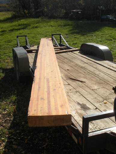

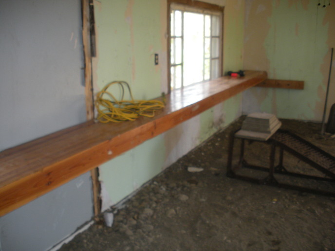

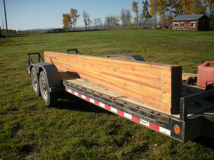

John Deere D
07-25-2020 23:09:37
Report to Moderator
 Re: Work Bench tops in reply to J. Schwiebert, 07-25-2020 11:47:14
All work benches are "Laminated Douglas Fir" beams from an old school. 20' long........:)
Some of the "Laminated Wood Beams" work bench's are 6" thick..............:) Bob.....
