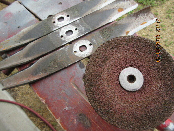

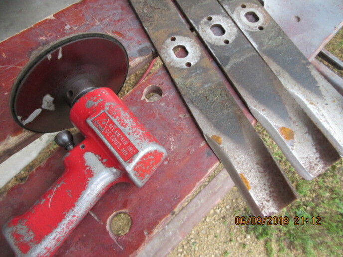

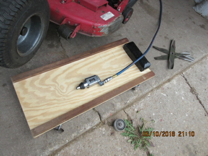

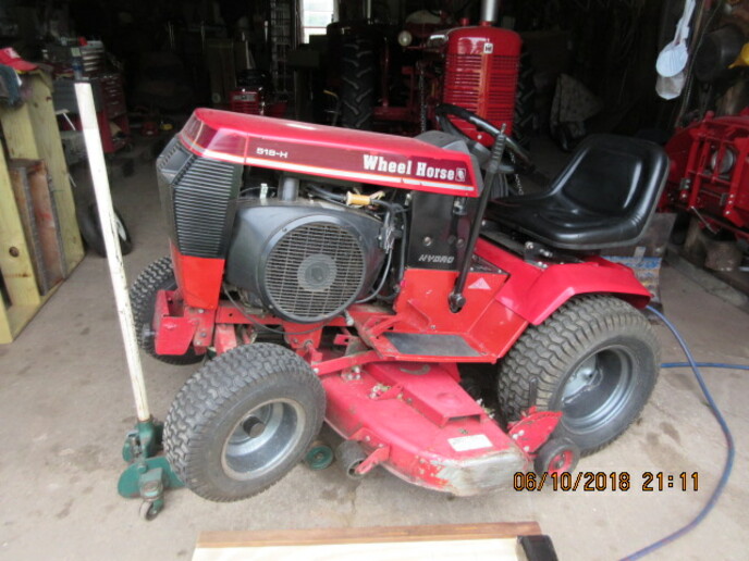

Floor jack--butterfly impact wrench and air grinder and 24 or 36 grit disc, fifteen minute job.
