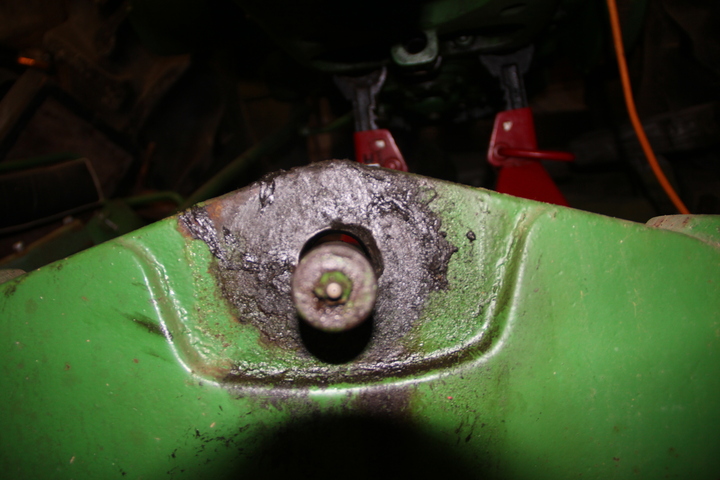

I have a HEAVY cast axle with a blown out pivot pin whole. Factory is 1 3/8, it's now pushing 1 3/4
I'm debating my options. If I had a mill I'd do that immediately. I'm just trying to see how I can get it done myself without going out for it.
Could I put a graphite rod in the hole of the proper size then build the wear up with brazing? I know it works with welding, I would assume the same with braze?

Greetings Brandon: You might be able to solder in a piece of thin wall steel tubeing, or weld it in place. I have arc welded grey iron castings several times, and have had the best luck with 6000 series electrodes. The nickle alloy rods made for grey iron
usually didn't work as well. One part couldn't be welded with either one. Bad chemistry probably. Good Luck!
You might be onto something.
1 1/4 pipe is 1.380 ID
The pin is 1.375 OD, so it'd be a good match
Thank you, you're getting my brain going, my main concern was how to get a decent hole after adding material!!!

Without a mill, how are you going to get a 1.66" dia. Hole for the 1-1/4" pipe exactly where it needs to be? Will the 1 .38 inside dia. Of the pipe be good enough? Common ERW pipe will have a light weld seam inside. Might have to use seamless.
The diameter should be doable, even if it needs a little finessing. Die grinder might clean up any internal welding.
Locating the pipe would be tough and I'm thinking up solutions, maybe welding it onto a plate on one side that will locate it while I do whatever else in the mess that is the original bore. I think braze but not sure. Then cut it off when done.
I'm thinking out loud.
Will it be a super precise fix, no, but a LOT better then how it is now and should be durable to last for my hobby use

I was born and raised poor....my father would weld that up bead after bead and grind it out...he would likely weld-up the pin too!
I am actually pretty sure I'll flip the pin 180 (it doesn't float, held in place with a bolt) and weld it up
The axle I was thinking of brazing, mainly because it's cast. I thought about brazing without a pipe but getting a round and properly located hole would be REALLY hard since I can't drill it back out.

Last year, I begged some milling machine time from a friend and did this to my Oliver 550 adjustable front axle. I used two bushings end-to-end in the bore (1-1/2 OD x 1-3/8ID).
I've got a buddy with a mill but the axle is too heavy for both of us to lift up onto it in his home shop. He's the first I asked.
He referred me to another guy who would do it, and the price was reasonable but more then I really want to shell out at the moment. Can't blame the guy, gotta make money.
The site doesn't have rods of the right size but I know I can turn one down. But I think I've got a workable solution if I get the right size pipe. I hate this little bit of rig job but it will last longer then me, and still be 100% better then it was

if your friend has a mill, can you get solid stock and take it out to the size you need instead of looking for a "correct" size pipe/tube? if its only 4 ish inches, stock wouldnt to be terribly bad, and hes your buddy, so a few beers...
