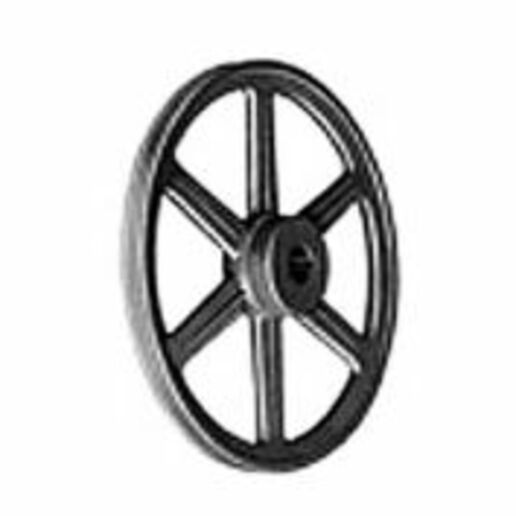

old_bc
06-29-2020 21:36:32
Report to Moderator
 Re: Motor pulley in reply to Phillip Tibbetts, 06-29-2020 03:54:25
Is this what you are looking for?
[Log in to Reply]  [No Email]
Russ from MN
06-30-2020 05:19:14
Report to Moderator
 Re: Motor pulley in reply to old_bc, 06-29-2020 21:36:32
They sure are proud of those pulleys!
