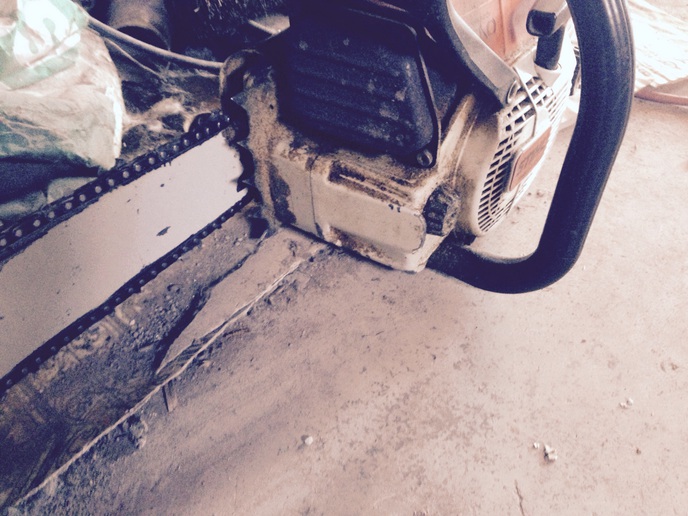

Well I did as some here suggested. Cleaned everything real good, checked the cap for dirt around it, ect. Filled gas and oil, used the saw. Still had a bunch of gas and oil in the saw. Took the saw apart meaning clutch cover, bar and air filter( I usually always blow out the filter when I've cut a bunch). Saw has been sitting now since Saturday. Only have a small oil puddle the size of a quarter. It has also been colder and now I'm thinking the temp changes are causing it to leak. No big deal a couple rags can't fix ! Thanks for everyone insight !

Most chainsaw oilers use a pump that will allow oil to seep by. It's not so much a design flaw as the simple fact that you need some clearance for things to function. I have 30 some saws. 2 are leakers. They leak more in real warm weather when the oil is thinner. Just the way it is.
