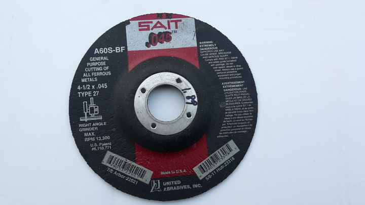

I have run hundreds if not more of the sait Blades. we only buy the ones for the larger grinders untill used down then they are about right for the small grinder

First off stop buying JUNK. Now here is my opinion about cut off wheels. The ones you named are all from the half right land. They are very brittle and have crummy internal structural reinforcement. I wear safety glasses ALL of the time. Had one of the dewalt ones shred and actually puncture my skin. This brand is a bit more expensive but more than worth the extra cost. Also last longer. I use .045 wheels all over the place. Now here is my recommendation. SAIT wheels are made in the USA. You can find them on Ebay for almost the same price as the store price for junk. There is an industrial supply place not that far from me and I buy ten or fifteen at a time. Please buy some and try them.

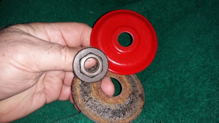

This is the backing washer and clamp washer on my 4-1/2" Craftsman grinder and I use them with all grinding and cut off discs with no problems. I have a light "tin" washer for recessed discs but I don't use it. Says right on it "For depressed center wheels only". If you were using one like that I would say that is why your cutting discs break.

like has been said flip the outside nut over for thin disc's

You need to flip the nut over so your using the entire flat side of the nut to hold the disk against the backing nut. If you have been using the side with the flange that centers wider grinding disks that is your problem. Diablo disks are good enough quality.
So your disk should fit the backing nut shoulder. Then the flat side of the clamp nut will hold the disk secure while supporting it out form the center hub.

One other question Dan -- How much do you torque the nut onto your discs??
With cutting discs, I never use the wrench. Just snug it up by hand. Rotation into the workpiece will finish tightening it all it needs.
Started doing that, as one time I was torquing on a cutting disc and heard a sound like the disc cracking; threw that disc away unused. Never "torqued" one since. That was many years ago and "likely" a cheap disc, but can't remember. I don't use cutting discs a whole lot.

first, thanks to all who have posted advice. The disks I got were from Home Depot, Diablo brand. Maybe not the best but I figured would be better than Harbor Freight. I've tried all of the thicknesses they sell, with the same breakage results. They've never been wet or thrown around in a tool box.
The regular grinder disks have a raised center, and the washer on the grinders I have (Craftsman heavy duty) is dome shaped to fit the raised center. Since the cut off disks are flat, do I use that dome shaped washer? I've tried drawing them up tight against the washer, which puts a lot of strain on the disks by pulling them up in the dome, and doing them not-so-tight, but have had the same results both ways.

 Re: grinder cut off disks in reply to Dan in North Houston, 02-10-2019 06:43:25
There is a big differences in cut off disks. I try to only use the US or German disks also. The cheap ones will shatter to easily. A higher speed grinder also helps. I use either a Metabo or a DeWalt high speed grinder for cut off work. Either way, hang on tight when those disks bind the grinder can take off. Nothing like launching a grinder to wake you up.
"There must be a trick to using them, anyone have any advice?"
By quality THIN discs, then keep a death grip on the grinder and keep it aligned with the cut so it doesn't catch and jerk and break the wheel.
I'll ONLY buy cutting discs that are made in USA or Germany.
I've been fortunate that what foreign-made discs I've bought have held up well. Have heard from too many folks that the Chinese-made products often fail due to lack of Quality Control and lack of using consistent quality materials.
[Log in to Reply]  [No Email]
It's the quality of the discs,not all discs are created equal,I've had good luck with Dewalt that I buy at Farm and Fleet,I'm a little leary of the packets of 10 in the discount stores because I don't want flying objects in my shop.

 Re: grinder cut off disks in reply to Mike Groom, 02-10-2019 07:09:29
Speaking of cut off discs, I'm having a real time trying to find the discs for my 4.5 grinders WITH the 5/8 hole, it seems that all I find is with the 7/8 hole! Does anybody have any great wisdom on this ?? Jim in N.M.

 Re: grinder cut off disks in reply to jim in N.M., 02-10-2019 09:23:46
You need to use the tightening nut from another grinder that has the larger ring. Far as I know they are all 5/8 thread but the nuts are different. Any repair center or even try Ebay. Also check out a local rental center where they rent tools. Usually have a junk box full of odds and ends. Take your grinder and all of your washers, brackets, disks, etc. They should be able to fit you up. My Dewalt has a nut you need to flip over just for that.
