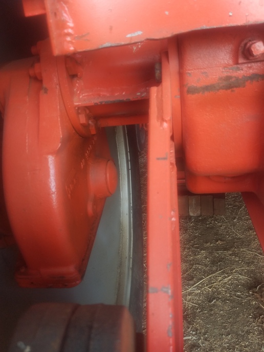

I don't think axles turn fast enough to make a difference. I made my axle housing from schedule 80 pipe. Found a demo derby guy he made the flanges. He thought it was so easy a job didn't want any mone. I did pay him. But I welded them. Cut off 10 on each side.
[Log in to Reply]  [No Email]
VicS
11-13-2023 06:13:01
Report to Moderator
 Re: Lightening bill gears / axles in reply to VicS, 11-13-2023 06:10:24
Picture. I know it's a Allis

 Re: Lightening bill gears / axles in reply to VicS, 11-13-2023 06:13:01
That is impressive. Thank you. One of these cold weekends Im going to take it apart and start grinding
