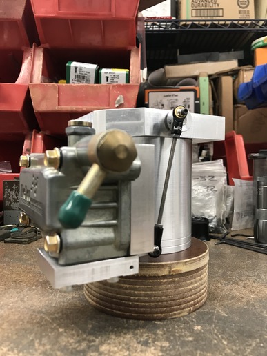

I have re-designed some of the round bore updraft carbs that I built some years ago. The reason was to make them shorter and more compact, to make it easier to fit them in cramped quarters, without giving away any of the air flow capacity or the ability to meter fuel efficiently. These are 4 1/8" tall, which is about 2 1/4" shorter than the old designs. The larger one is 385 cfm, and the smaller is 250 cfm. This design can be used to build carbs that range from slightly below 200cfm to slightly over 400 cfm. Each carb is custom built to suit the tractor its going on.

As you can see,these carbs use a Holley fuel bowl, a custom accelerator pump housing, and a direct link from the throttle shaft to operate the accel pump. The metering plate (not shown) is jettable on both of the metering circuits, on jets and air bleeds. The whole carb design is concentrated on helping the engine make better power over a wide rpm range, AND have the drivability needed to control tractor speed and engine power.
The design on the throttle body allows the use of an adapter plate (usually 3/8" thick), to allow the carb to be turned 90 degrees, or to adapt to a different center to center distance of the intake manifold flange bolt holes, and/or to adapt to manifold flange bore that is slightly larger or smaller than the throttle bore of the carb. The adapter plate can handle any one of those situations, any 2, or all 3. It is recommended that the intake manifold bore, at its flange, be the same size as the throttle bore of the carb. But sometimes that isn't possible or practical.
