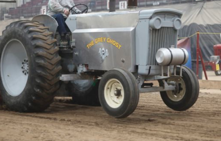

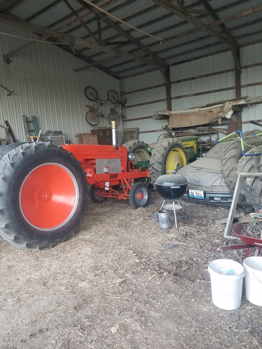

Do you guys think some 2x4x1/4 thick walled tube would be heavy enough for a front axle on a tractor that will pull up to 10,000 pounds? Thanks.

He pulls to 6500 with this Moline. Never carries any front end weigh, mostly in the middle if he needs some.

I think it is to heavy. Run braces from king pin up to the frame. Triangles are the stronger than anything.
