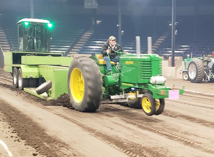

Was a good day and I always behave myself. Ray put a nice picture of me and the G on his FB page. I told him to not let you see it or you would be jealous. HA HA

I saw it--Don't know what that pretty wife of yours saw in you--Ha-Ha
