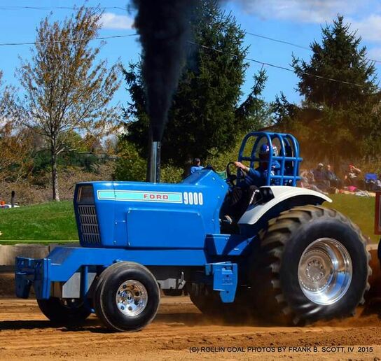

Kdl, There are NO SECRETS among serious contenders in tractor pulling. A stroll around the pits will reveal the differences between as sold and as equipped. Before the pandemic I have pulled for many years with two Fords, a 960 and a 9000. The 9000 had a shipping weight of 10,600, and in different years I pulled it at weights from 7,800 to 13,000. While I am not suggesting that you go to the lengths that I did to remove weight, this illustrates what is possible. At one pull some years ago in Massachusetts I entered six classes and won four of them. The two lightest and the two heaviest. There are many lightened parts available for your tractor, many have been discussed over the years here. The most common is to replace cast rear centers with pressed steel. Another is to eliminate the PTO and install a "flatback". There are many after market repop parts made of aluminum such as the pedestal, and often a smaller radiator or starter is swapped in. I am not a "Deere" guy so I don't know the specifics, but you could find out by simply observing the 720s 70s and Gs pulling in 6000 to 8000 and checking them out. I am not suggesting that you do any or all of what I have mentioned or what you may see, but you asked how to make your 720 lighter and how to be more competitive. Here is my 9000.
Nice looking Ford--I have always liked that series. Do you have any Forrestal-sp? parts in it--As you know-they can make a Ford run!---Tee
Don't know who this is but in sure is pretty

<img src="https://www.yesterdaystractors.com/cvphotos/cvphoto69428.jpg">
tee, I do have some Forrester's parts in it. They also pointed me to some guys for injection work.
