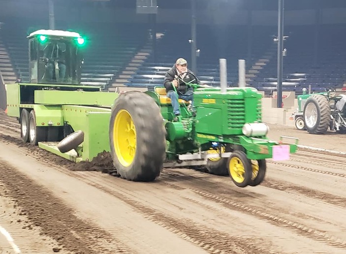

I pulled with this G for years and my wife and grand kids pull it now. My wife finished 3rd in points in 1 class pulling against the best in NATPA last season. We run 2T with 14-9-38's on it. No stroke, a good cam grind from Brian, bored to 6 3/8's with high compression pistons, some carb work and porting done on a stock JD head and manifold. She picked up 2 wins in Sigourney this summer with it. Would make a cheap build for you if you want to be a little more competitive than say an A would be. We run Renegade 120 octane fuel in it. Compression is high enough pump gas won't work.
[Log in to Reply]  [No Email]

That’s a mild stock Jon Deer ❓
