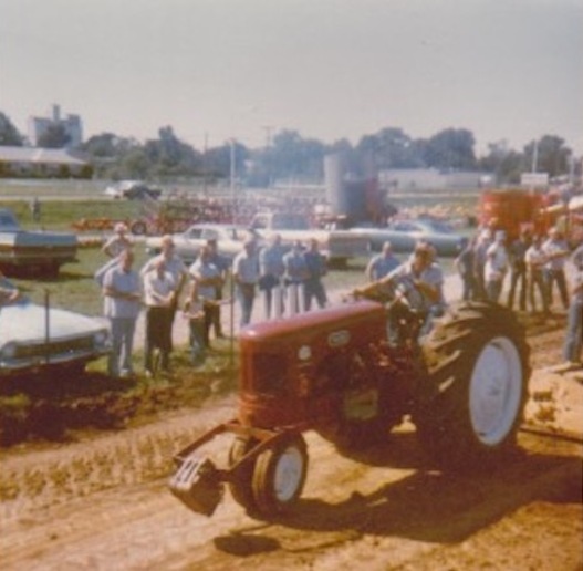

Years ago I pulled a Wards tractor with a 265 Chrysler that was from a MM combine..It was bored .125 with Jahns 10-1 pistons..You could figure on splitting a cylinder every year....It had a Isky cam with heavy valve springs..It had dual carbs and dual exhaust..It dynoed 120 horsepower at 2000 rpms....We turned it 6000 on the track.
The picture is a friend pulling the Wards at Columbus,KS in 1974.

 Re: who in ohio builds chrysler flat heads? in reply to 1206SWMO, 07-03-2020 12:02:59
6000--WOW--If I was one of those people by the side of the track--I might have stood back just a little--BOOM--Thanks for the pic.---Tee
