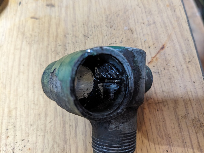

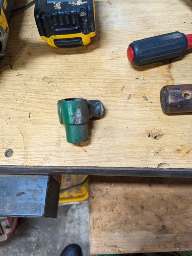

BrotherJoe
11-20-2023 11:29:48
Report to Moderator
 Re: 1850D Tachometer Drive in reply to rrlund, 11-20-2023 09:36:55
Thanks rrlund; maybe these pics will help I assume the gear in the second photo is what you're talking about?
Is there any other fix? I assume the cable was damaged or something caused the drive not to spin and it chewed it all up..

rrlund
11-20-2023 12:35:03
Report to Moderator
 Re: 1850D Tachometer Drive in reply to BrotherJoe, 11-20-2023 11:29:48
I turned the worm gear around. If that driven gear is chewed, I'd turn that one too if you can.

BrotherJoe
11-20-2023 13:42:54
Report to Moderator
 Re: 1850D Tachometer Drive in reply to rrlund, 11-20-2023 12:35:03
The worm gear off the engine appears fine. The driven gear inside the 90 is what looks chowdered up on the edge that mates with the fixed gear. Oddly, they don't mesh very far together based on the amount of that gear that is gnawed up.
I looked at my 2-105, also with the Perkins. Same CAV pump and the same housing as the 1850, however, instead of there being a worm gear parallel to the block at the front with a 90deg drive, the tach on the 105 goes straight into the backside of the housing, facing the cab.
Is there another option to get a tach going that people have done; the gear inside the 90deg looks like it's had it's last... How do you properly get those caps off that 90deg? I knocked one out with a punch, but, it chipped off the lip (figured no big deal since the drive isn't sealed; I can fix that).

rrlund
11-20-2023 15:08:34
Report to Moderator
 Re: 1850D Tachometer Drive in reply to BrotherJoe, 11-20-2023 13:42:54
I think that's just a soft plug that's staked. I guess I did it the same way. About all you can do is put it back in and take a chisel or punch to bend the edge back over.

BrotherJoe
11-21-2023 06:15:51
Report to Moderator
 Re: 1850D Tachometer Drive in reply to rrlund, 11-20-2023 15:08:34
Thanks; I pried that cover off and filed the gear teeth to take the gnarled rolled over edges off and now it does drive.
