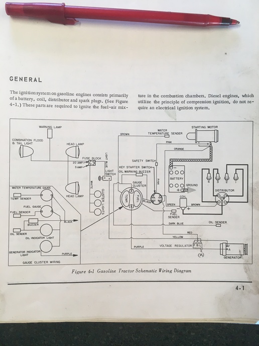

Seriously, I'm going mad here. The ignition switch was going bad which ended up trashing the bendix mechanism in the starter. I replaced it and redid some wires while I was at it and now it won't start! Starter cranks just fine but I am getting NO spark at the plugs and no spark out of the coil. Can someone please walk me through how to find what is wrong? Part of the problem is this is a positive ground machine with a 12V battery and so the manual is not helping me much.
This is what I did so far:
Jumped the battery straight to the + side of the ignition coil (it is + to + right??)
Replaced the ignition coil
Nada

I used the test light and it confirmed the points were never closing. After gritting my teeth abd prying off the rotor (which looked like it had been GLUED in place) I found this:
[Log in to Reply]  [No Email]
Katep
02-19-2021 08:56:44
Report to Moderator
 Re: Oliver 550 no spark after replacing STARTER in reply to Katep, 02-18-2021 17:01:31
Thank you so much for your help! I wish I could go back and edit my original post I left off "converted" from positive ground. This is the coil I got which I think is correct? I also tried the old coil. I got a test light but haven't had a chance to go out again yet today because I'm sitting here waiting for PS5 to go in stock at Best Buy for my 17 year old's birthday present lol. But when I checked the distributor yesterday with the multimeter this is what I got:

"14 volts on + terminal of coil to ground" This indicates wiring and switch working up to this point
"14 volts on - terminal of coil to ground" This indicates there is continuity through the primary of the coil, but that the points are not making contact to ground. If points are open this is correct, if points are closed there is a problem between wire connection at coil - through distributor and points to ground.
"infinite resistance between - terminal of coil to distributor with machine off" Should be very low resistance from - post of coil to side post of distributor. If not check for bad wire connection.
"NO needle movement on resistance between - terminal to distributor with starter cranking." Indicates points are not closing or making contact. Be sure they are properly adjusted, then take a dollar bill, fold it up and drag it through closed points to clear any tarnish that may be on the points. They must be clean to make contact.

"Part of the problem is this is a positive ground machine." Positive ground is really just a mental block, not an electrical problem. Like right hand and left hand threads on a bolt. Positive and negative ground, current flows in opposite directions. Just have to configure battery, charging system, ammeter (if used), and coil for that particular ground. Starter and lights don't care.
"Jumped the battery straight to the + side of the ignition coil (it is + to + right??)" In this case, probably not. Properly configured with positive ground, + post of coil goes to the side of the distributor and is grounded through the points. With negative ground the - post on coil goes to side of distributor. So with positive ground, your + post should go to side of distributor.
If you connected + battery to + on the coil you just grounded the output of the coil so points had no effect. Try hot - battery post to - input post to the coil.
+ to + and - to - is correct for battery charger and jumper cables. To test coil you want hot battery post (regardless of system polarity) to input side of coil. Output side of coil does not connect direct to battery.
Get the test light, connect clip to ground (frame or positive battery post). With switch on the light should glow when probe is touched to - (input) coil post. If not you have a problem in your switch / wiring between - battery post and the coil. If light glows at - post of coil, move probe to + post of coil. When you crank the engine the light should flash. If light is on solid points are probably not making contact, if no light check for short in points or distributor feed through.
Did you get the correct new ignition coil? According to diagram I have it should be a "12 volt no external resistor required" coil. It should have approximately 3 ohms resistance across + and - posts of the coil.
If you have a "12 volt external resistor required" coil (1 1/2 ohms from + to -), you can either exchange it or add a 1 1/2 ohm resistor in series between switch and coil input.
