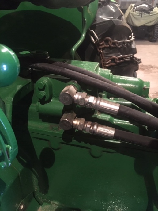

Im working on setting up a remote cylinder on my Oliver 550, but am unfamiliar with these hydraulic fittings. The fittings appear to be plugged from the inside (maybe?), but weep slightly when using the tractor.
I see remnants of part number lettering, including the quotation marks, but I havent found anything useful from a web search yet. AEROQUIP
A5206-SI-8
What kind of fitting mates up with these? Is it some kind of quick-coupler? (Or maybe a slow-coupler?)
Thanks in advance.

 Re: Hydraulic fittings on Oliver 550 in reply to NAllen, 01-10-2021 20:43:58
Im fairly certain this is a factory setup. It matches the images in the parts list.
This image shows an angled view from the right side of the tractor, toward the left rear wheel. There is a 45 deg. street ell (pointing down and back) between the valve block and each hose.

 Re: Hydraulic fittings on Oliver 550 in reply to NAllen, 01-15-2021 22:18:25
Thanks for the photo. Yes, that is a factory remote valve. They are hard to find. Enjoy your new Oliver!
I know 2 things, I am older than you guys. They are Aeroquip couplers and the O-ring on the inside needs to be replaced. You don't look at semi dump trailers too often. Areoquip couplers are very popular for the hose on dump trailers only they are larger!
The first 77 that I bought, back in 69 had those on it. I tossed them and bought a breakaway clamp and some Pioneers for it. It was some years later that I bought a Hydralectric cylinder that had the other ends that mate up to them on it. I guess I should have saved all the parts for a conversation piece, or at least have taken some pictures of them. Hindsight's 20/20.

 Re: Hydraulic fittings on Oliver 550 in reply to NAllen, 01-10-2021 20:55:57
Those are an old style not used much anymore, plus they leak like a sieve. Best all around cure is to replace them with new pioneer couplers and male ends. I think you will need couplers that will couple under pressure. If the 550's are like all of the other Olivers, the hydraulic hose has constant pressure, shutting the tractor off and moving the lever does not relieve the pressure on the coupler. That style was on the 880 that I bought with a loader on it and they leaked a steady stream when it was running. I have replaced them.
