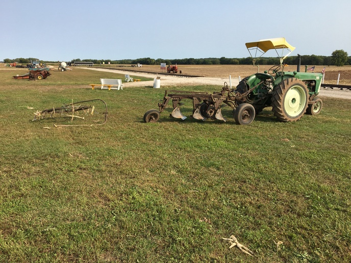

Does anyone have a operatorís manual for one? I would like to know what the rear wheel is supposed to be set at. I had to slide my drawbar to the right to get the plow lined up with the furrow. The plow is adjusted as far as it will go and still doesnít line up right. Looks like Iíll have to move the fender to the inside of the mounting bracket in order to move the wheel in far enough to get a straight pull. Any suggestions?

   If two beams come to the front cross bar it's a 4240, 2 or 3 bottom.   If three beams come to the front cross bar it's a 4340, 3 or 4 bottom.

That is an early 4240 plow. If you are going to get a manual, get the correct one.

Thanks, I was told it was a 4340.

Super, I have a 4240 but only two bottom. The 4340 has a15 inch tail wheel. Not a good picture.
