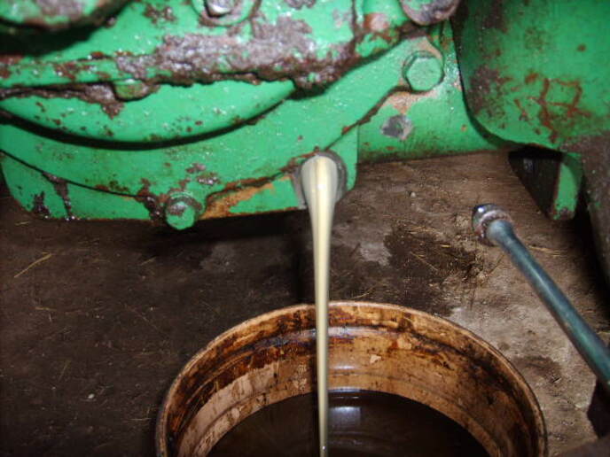

Looks like a good one. Check the hydraulic and trans/diff fluid for water and contamination. Look what came out of mine. There was a service bulletin to raise the fluid level to ten gallons from
eight. A two inch nipple, elbow, one inch nipple and cap.
