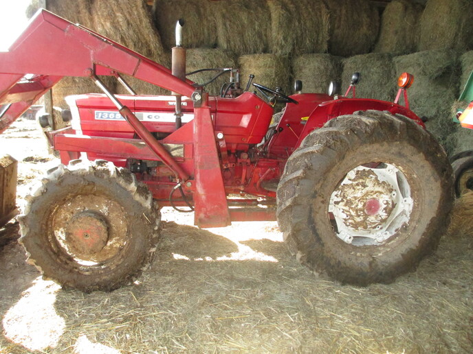

I looked high and low for one for a long time, finally found one with a loader. I got it from a jockey, he had bought it at an
auction in Canada. It was red with Cockshutt decals, but it was as close as I was ever going to find. I gave $5800 for it. Great
little tractor. I've started it at -18F without even plugging it in, just using the Thermostart manifold heater. I don't think
you'll ever be sorry if you buy one.
Before and after of mine. I needed it to be an Oliver.
Since Randy is showing off his before and after, here is mine. We use it all the time and I will be long dead and gone before it is ever sold. I saw a 1265 FWA sell for $5-$6K earlier this spring, that seems to be a fair price for one of these 65 series Fiat Olivers. Great tractors.
