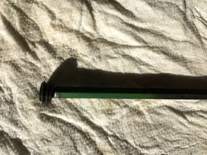

Started taking the pto clutch of the 550 to replace seals. Book says to take the set screw out of the clutch housing to get it off of the shaft The Allen screw broke in to, top part came out and the rest is still in the hole. Any ideas on how to get it out? Thanks, Chris

GDB is correct---That is a 2 piece set screw. The outer one being a lock that's about three threads long

It maybe another shallow set screw, I believe they used one on top of another as a lock.

I hope your right, I was scared to try getting to other piece out for fear of making it worse. Guess we will find out. Thanks, Chris
