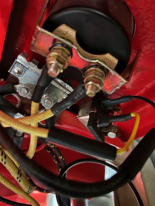

Why would this new light switch arc or spark when I turn off the lights? It had worked fine a few times when i tried it for the first time since putting together then it all of a sudden blew a fuse. All wiring is new brillman harness and no connections are shorting out unless inside light housing. Replaced about 3 fuses and now it works again but sparks badly when you turn the lights off. ??? Bad switch? I will say that the quality of the switch doesn t look the greatest.

In the second picture one of the wires (to the ammeter) looks very close to the ballast resistor. It may be the camera angle (it most likely is) or the wire to the switch may be (isn't) touching the ballast resistor (except that's not the light switch). Other than that it is a nice neat looking installation.
The ballast resistor can get very hot and burn through the insulation on the wire to the switch, but t isn't close to that wire, so it can't) . Before blaming the switch, I would make sure the wire isn't just shorting to the ballast resistor (which it isn't. It would be nice if I could delete this whole response.) This post was edited by Dave G9N on 11/26/2023 at 10:00 pm.

In your picture it looks like the black insulated part of the switch the fuse and terminals connect to has slid out of place. Looks like you were GOT by the ..land of almost right.. I would be kind of embarrassed to post a picture of that on line. The switch gave you problems you replaced the fuse 3 times and it even gave you a shower of sparks to point directly at the problem??!! I guess you can at least be sure of the problem. BTW, disconnect your battery immediately and unplug that light switch.

i have a cheap fused TSC switch in mine, it's never tried to set the tractor on fire or electrocute me (at least, that i'm aware of) :)

That, and I'd go with a marine grade switch.
Those fuses saved your wiring..... .

I would return it saying it's defective and get a different one
