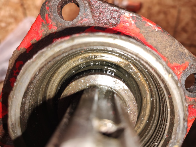

Greetings all, as of late my 52-8N has been slipping out of PTP engagement while using the Bush Hog only. It does not disengage on it's own while using other attachment's such as disc, rake Etc. any suggestions as too look at ? Regards

Quoting Removed, click Modern View to see. I wanted to follow up on my findings, after I pushed the bearing retaining sleeve up against the bearing it's self thus not leaving any play between the bearing, I reinstalled and tested. All was good. Not coming out of drive any longer. Thank you for your help.

There should not be any end play in the PTO shaft.
For the cause see Ultradog's reply in this thread.
In your case the rear bearing retaining ring has been driven back a bit allowing the PTO shaft to move forward and backward. This can be fixed by driving the rear bearing retaining ring tight against the bearing, and shortening the offending PTO driveshaft on the offending implement.

. I removed the assembly and and the bearing looks good. The sleeves in front and behind the bearing on the drive shaft are giving me a reason to question due to the gap between the housing with the bearing. It is at least 1/4 of an inch of play between the two sleeves. Any thoughts ? I would like to post a picture if I can figure that out.

Probably the most common cause of the pto slipping out of gear is the snap ring in the bearing retainer has been pushed out of place. And the most common cause of That is the telescoping driveshaft on the mower is too long.
If you watch closely when you raise the mower the lifting pushes the telescoping driveshaft forward slightly. It is the geometry of it all. Having too long of a drive shaft is often compounded by the need for an ORC (over running clutch).
The fix is to first, replace the snap ring and second to check the length of the drive shaft. You want about 1/2 to 1in of freeplay when the driveshaft relescopes to its shortest length.
This advice holds true for pretty much any tractor with 3 point hitch.
Fortunately on an N it usually damages just the circlip or bearing retainer.
On other more complex tractors with hydraulic pto clutches, too long of a mower drive shaft can cause more severe and expensive damage.

It's a PITA. Most folks just buy a replacement shaft w/ the seal. bearing, etc already installed.

In no particular order..... ...
A loose PTO bearing.
A badly worn bearing
A broken or missing snap ring groove in the PTO bearing housing
The PTO coupling splines can also be worn and cause it to jump out of gear too, but that's rare.
