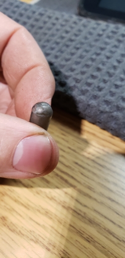

Looking for opinions from you guys about reusing this interlock pin in the shift cover of my sherman combo. Also where would I be able to find a replacement pin. Thanks in advance

Yep,Just use a drill to chuck up the pin and a grinder to round it up.

I'm getting ready to make one myself. I just went out and got a hardened 5/16 rod and I'm going to attempt to use a small fine grinding disk to round it nicely. I have 2 foot of rod so I can make a lot of mistakes.

I went into my local town to a metal fab shop who said they couldn't help. Happened that another customer directed me to a retired machine shop guy who does a little work to stay busy. Went to see him and he said he would turn 1 from an old dowel pin. We'll see how it looks next week

I made one out of a dowel pin and with my lathe and a small hand held grinding disc. to radius the ends, I think it was 5/16 diameter. Just use a caliper and sneak up on it.

Hidude ,If you can not find a new pin (probably won't) I would check the diameter and find say a grade 8 bolt and make a new one.Make it the proper diameter,and length with the ends ground round like the original pin.To make it shift better like new,also replace the spring if it is weak.
