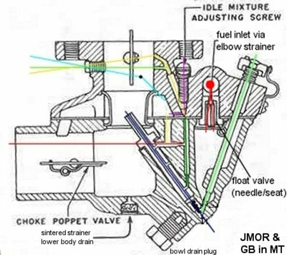

Phil N
11-22-2021 03:28:23
Report to Moderator
 Re: Secret to Starting a 2N in the Cold Weather in reply to wsmm, 11-21-2021 16:32:20
Notice in the Carb cutaway picture, there is a small passage starting at the bowl gasket parting line and goes straight down to the atomizer tube passage (shown in green ). The carb casting is made of cast iron and this passage gets rusty and gets partially or completely blocked causing hard starts especially cold. The passage shown in yellow going up from the idle mixture screw and into the throat can also be a problem. The picture is a Zenith Carb but the Marvel carbs have the same passages in the same area. Carefully remove, disassemble, and clean carb especially these fine passages. Run a fine wire thru and blast with carb cleaner and compressed air.

Phil N
11-22-2021 12:46:55
Report to Moderator
 Re: Secret to Starting a 2N in the Cold Weather in reply to Phil N, 11-22-2021 03:28:23
My tractor DID sit in the weather for a few years before I got it and the inside of the Carb casting had some rust. I did a carb clean up and rebuild kit. I missed the passage in green in the picture in my earlier post. It ran OK but started hard, especially cold starts. I took the carb apart again and thoroughly cleaned all passages. Then it started very well every time. That was 21 years ago and I haven't had to touch the carb again since. Of course the Ignition and electrical system was all gone through 21 years ago with a 12 V conversion, 10 SI Delco alternator with built in electronic regulator, and a Pertronix Electronic Distributor conversion. All has worked great for the 21 years. It is garaged and it's an Allis Chalmers WD with Zenith Carb. 6V died with Elvis.
