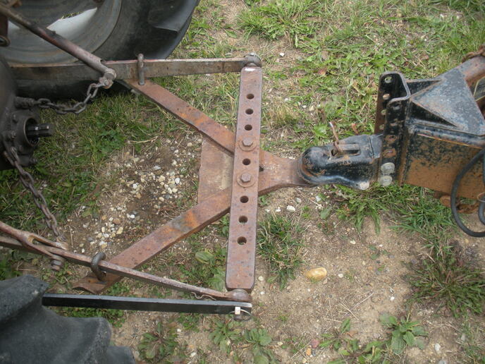

The guy who I bought my 8N from called me and said he found some spare parts in the garage that he believes are from the Ford. So I went there and pick them up. I was happy there was a Vee-Bar in the there. But I need some info on how to correctly connect it. Also it looks like it's missing one J bolt on one of the arms. Should I be able to get them locally?

It all depends on how "original" you want it. The original have a very sharp square bend so they fit tight on the lift arms & are fine thread. I have another one w/hardware store J-bolts that work ok but "kind of" fit & are not as strong because I could not find any w/as large diameter.

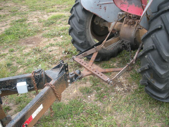

The DEARBORN VEE-BAR was an optional FORD dealer accessory and required all the OEM additions, the 9N-5182 11-Hole Drawbar; and STAY BARS with the WARNING SAFETY LOCKOUT
BADGE. It used two special 'J-HOOKS' with 5/8-18 Threaded ends and lockwashers with 5/8-18 Hex Nuts. As stated, Red Rock Manufacturing, Pella, IA, repops the J-Bolts
exact as original. The correct setup is as I pictured on my 8N and stated.
FORD 8N TRACTOR w/OEM STAY BARS; 9N-5182 DRAWBAR; DEARBORN PTO ADAPTOR; AND DEARBORN VEE-BAR:

Here is a picture of my V bar hitch.

Finally got a pic of what I think is an original J Bolt. Note (if you can from the poor quality pic!) the sharp square bend, the fine threads, & the oversize burr that takes 1 1/16" wrench.
(quoted from post at 15:12:25 09/17/21) Finally got a pic of what I think is an original J Bolt. Note (if you can from the poor quality pic!) the sharp square bend, the fine threads, & the oversize burr that takes 1 1/16" wrench.
I can make them easy. Are they 5/8" bolts?
So some images show the v bar mounted on top and some on bottom. Common sense tells me it doesn't matter. Is it?
