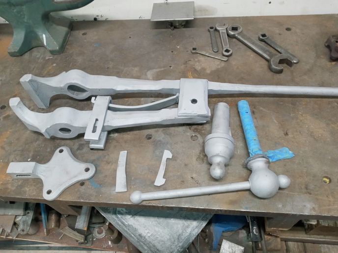

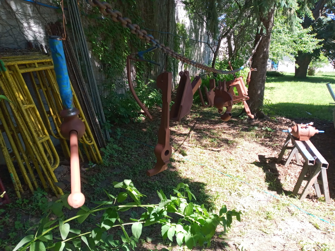

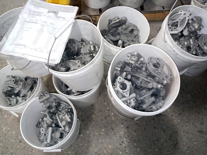

There is a small, high tech foundry near my house. I have gotten to know the owner quite well. He lets me go there on second shift when all the big wigs have gone home and use their sand blast cabinets to clean up parts.
I have posted about these carbs here before.
They are the top of cast iron Marvel Schebler carburators. Tonight there were several pails of them that had just gone through the sand blast cabinet to remove the last of the sand mold they were cast in and about 500 more on pallets to be blasted.
They cast the bowls there too.
I am kind of proud to live near one of the last factories left in America - or so it seems sometimes. So if you can, consider the folks who work there the next time you buy some parts. They are good paying jobs and they make high quality products and not a throw away piece of junk thing.
By the way, though I have sandblasted many, many tractor parts there it was an antique vise I blasted tonight.
I see a date hand stamped into it.
Says 1899.
I will clean it up and paint it then mount and use it. Like the MS carbs I saw there tonight it should easily last another 80 or 122 years.
Buy American.
Third Party Image
Third Party Image
