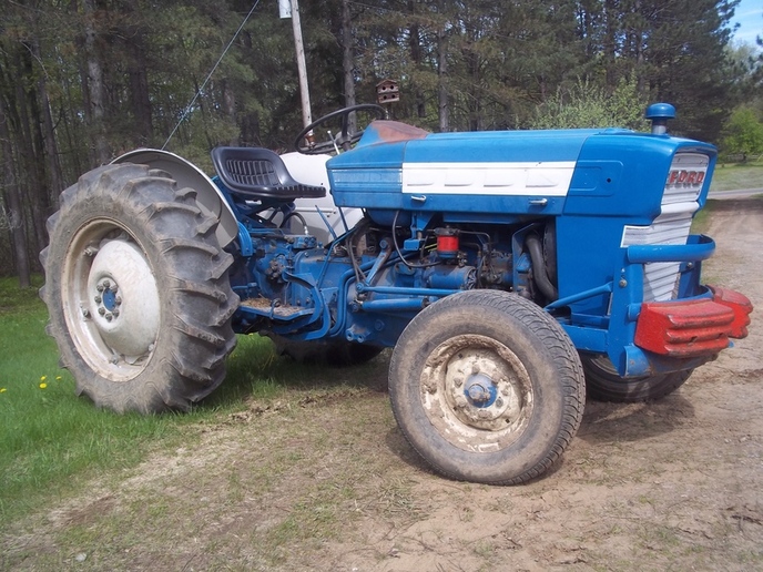

The very early 3000s could be ordered with power adjust rims and used those adapters. I bought one that had them and parted it out. Rims and tires were junk so I sold the adapters. Someone here on YT bought them but I don't remember who.
That tractor was from Kansas and had zero rust. It had the early (1965-68) style tin which I prefer. It was the most perfect nose and upper and lower grills I have ever seen.
I painted them and am still running them on my own 3000.
Third Party Image
