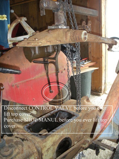

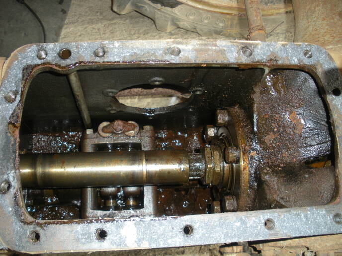

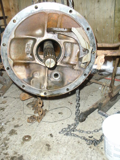

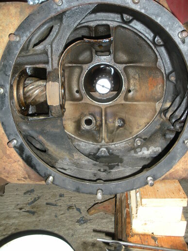

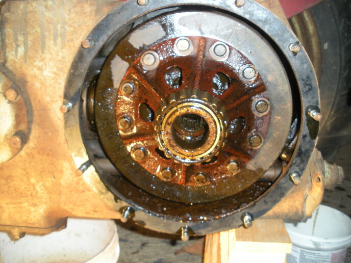

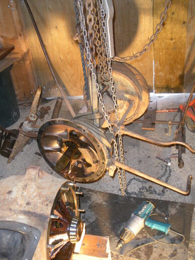

I was probably given fifty different suggestions from fifty different owners on cleaning the common sump, Trans, Hyd, Diff.
To become acquainted I made my mind to go as per pictures..
Before I removed AXEL housing, I drained all OIL...added Diesel fuel.. inserted 1/4" steel line into top of Transmission..added 15 psi of air and agitated Diesel . Drained Diesel and repeated procedure.
I'm satisfied with the end results
Bob...Owner 2-N
