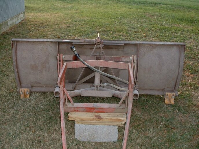

I happened to see this info on a SAUDER (Spelling)front blade..
I have no experience with this blade arrangement...
Bob.. Owner 2-N and other coloured Tractors..
I happened to see this blade at a dealer ship couple of years ago.....
Interesting design....
Bob....Owner 2-N ,TEA-20 Ferguson and several other coloured Tractors..
The Sauder is unique as it is a "quick attach" once the mounting brackets are on the tractor. Would have to be careful plowing snow with one as there is no trip mechanism or springs that snow plows have to prevent coming to an instant stop or bending up the plow frame if hitting a frozen edge. The Dearborn snow plow has trip springs.

(quoted from post at 12:06:41 10/15/20) The Sauder is unique as it is a "quick attach" once the mounting brackets are on the tractor. Would have to be careful plowing snow with one as there is no trip mechanism or springs that snow plows have to prevent coming to an instant stop or bending up the plow frame if hitting a frozen edge. The Dearborn snow plow has trip springs.
The blade in those pictures is the dozer blade. Sauder also made a snow blade with trip springs. And its also easy to retrofit a modern truck plow to the frame.
I have had both and the Sauder quick attach arrangement and hydraulic lift cylinders is a big improvement over the Dearborn bolt on 3pt cable lift designs. Still have a Sauder subframe I salvaged from a loader and a Meyers 7' plow in my "to do" pile.

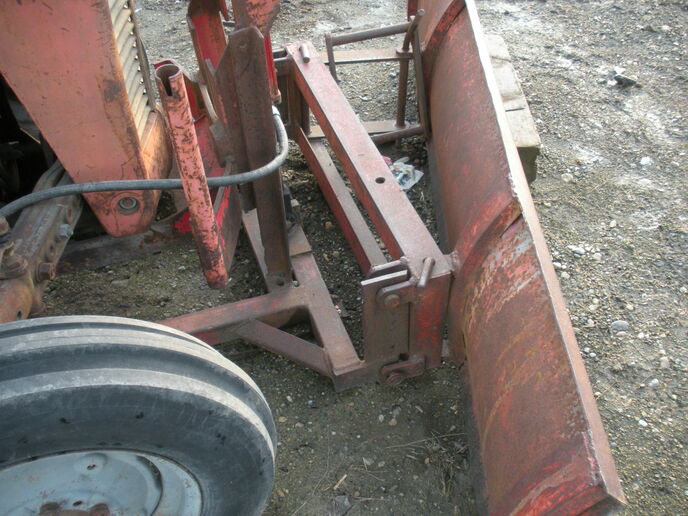

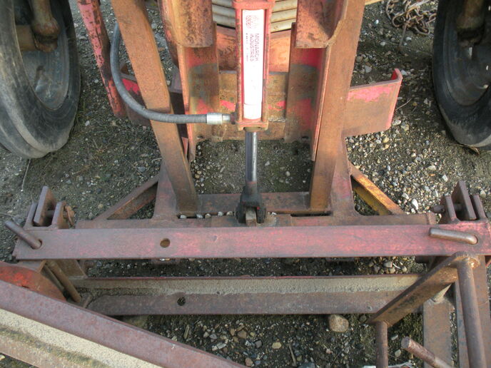

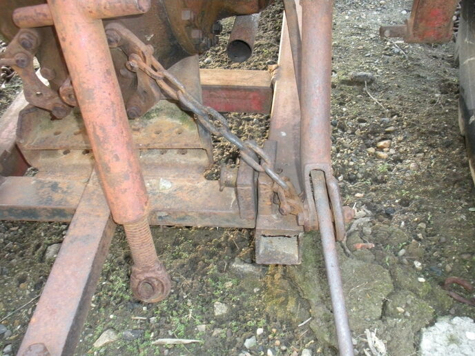

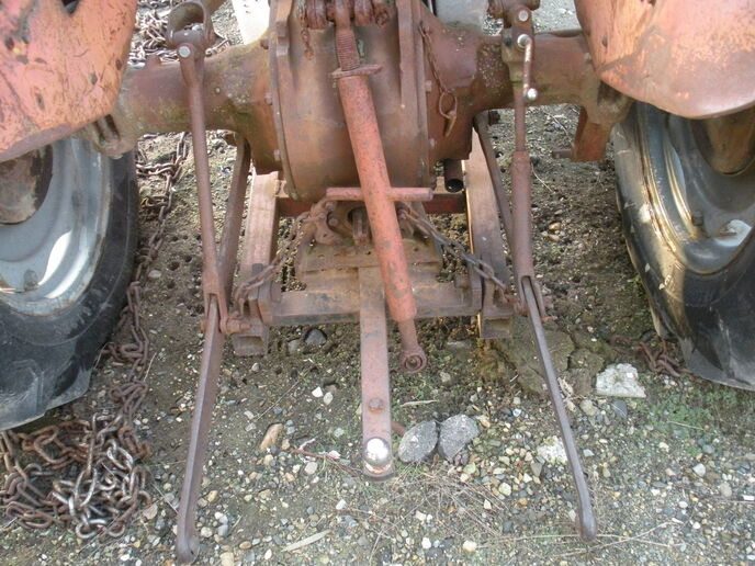

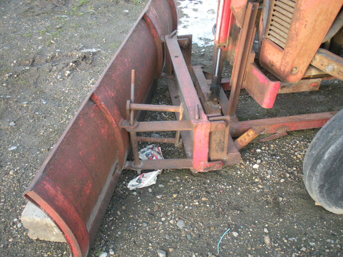

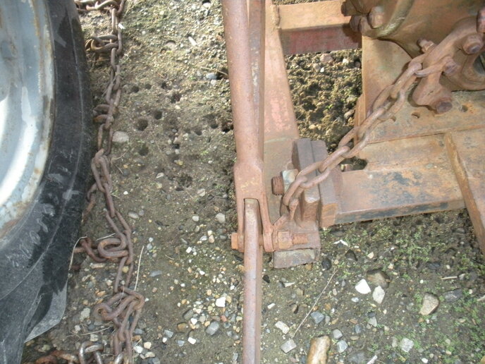

(quoted from post at 15:34:47 10/16/20) I have a Blackhawk in eastern Iowa. Requires a hydraulic hook-up.
have that same unit. I had assumed that the previous owner had added the brace to accommodate the 6 cylinder engine length. Now I see the original used both mounting braces. The mounting bracket was modified to catch the rear brace. What model is yours and where would the tag originally have been?
Thank's for posting the photos.

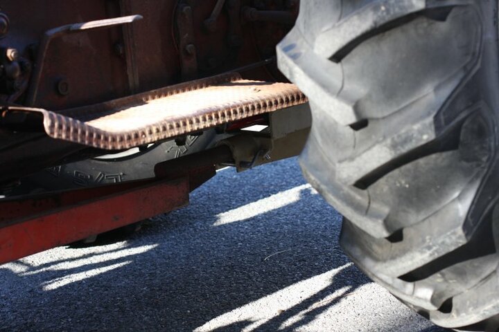

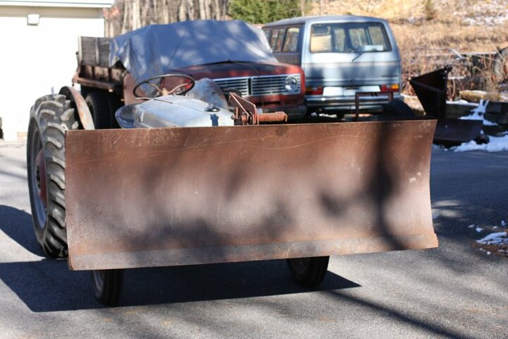

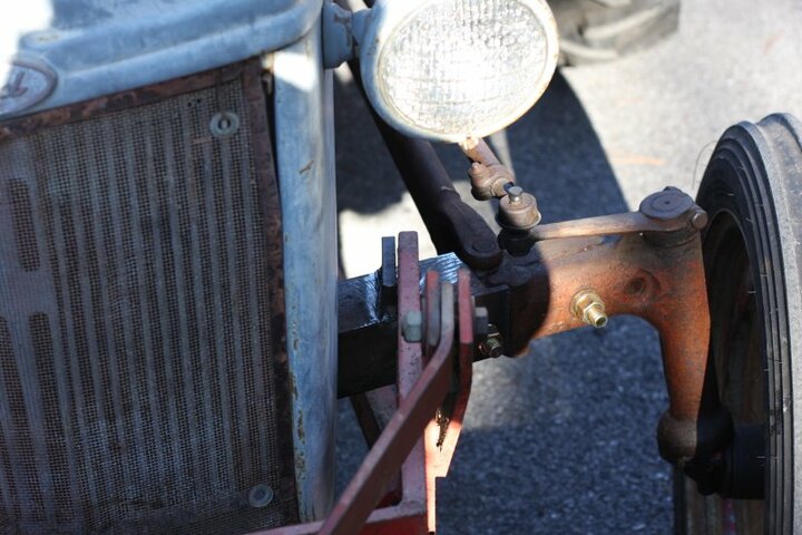

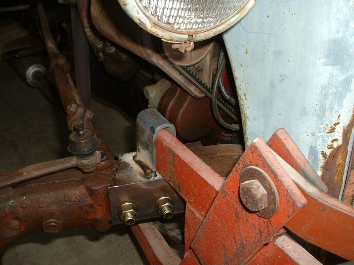

I have the same one on my tractor here in Maine. It is simple and does a good job.
Model is AD 456 I think - it's not completely clear. It's right behind the bracket that bolts to the front axle (I think! It's too dark out now to see!)
(quoted from post at 16:43:47 10/17/20)

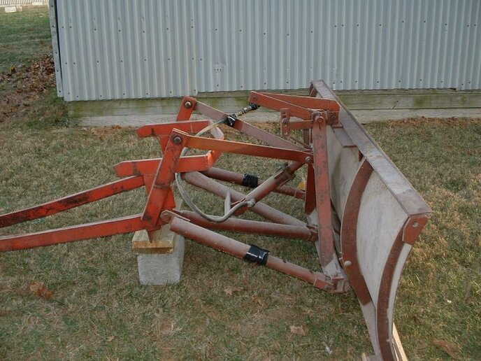

d Gooding posted the ARPS/Blackhawk manual on the N Board under manuals. The blade is designed to work off of the tractor hydraulics or with the Sherman backhoe.
I have this same blade and mounting system. I thought it was a good "home brew" with the pipe members. A few good things about its design is that it does not put the push forces on the front of the tractor, but all the way back to the rear end where the forward pushing forces are. The frame and blade can pivot separately from the tractor and front axle so the blade can follow the ground quite well. Mine has 2 springs for trip. The hydraulics were supplied by locking the 3 pt arms in a raised position and then the hydraulic fluid is taken from the test port on the bottom of the Hyd pump and sent up to a standard 2 way valve. Of course the lift action is slow with the 2 +/- gal per min pump capacity. Thus the somewhat small diameter hyd lift cylinder at the front. The lift cylinder should be attached to the blade frame with a short chain so the blade can "float" on the ground. I pushed a lot of snow with this in the 70's and also pushed a lot of dirt while building my house. It is a pretty tough system.
