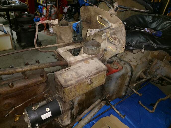

I'll try to attach pics of the air cleaner as I was tearing my 2N down a couple years ago. You can see the screen topper pulled off.

That's the cleaner on my 9N. The body has steel mesh baffle material, you can clean that or buy new. I'm not sure if "new" is Chi-Com crap?
Bottom just dump out old oil, wipe clean, and refill w/oil. Don't overfill or it will suck oil into engine and foul plugs. Original cup inside has a indicator for oil level.
That steel wool like stuff inside is not steel wool. Don't replace with steel wool. You can buy the new correct material from Y.T. It comes out of the cleaner by carefully bending the little tabs that hold the bottom baffle on.
(quoted from post at 09:43:08 09/16/20) That steel wool like stuff inside is not steel wool. Don't replace with steel wool. You can buy the new correct material from Y.T. It comes out of the cleaner by carefully bending the little tabs that hold the bottom baffle on.
You can put the whole thing in a bucket of diesel fuel and lift and drop until clean
