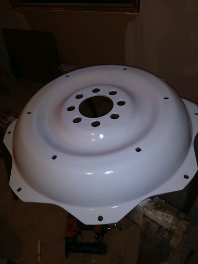

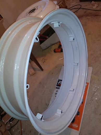

Don't forget that you can use a brush on your tractor too. Buy a good "china bristle" brush and have at it. Brush painting your tractor is Ford Approved :)
This Blue thing is off a later model Ford. It was brush painted. Brushing usually requires 2 coats btw.
Here's some rims and centers I brush painted too.
