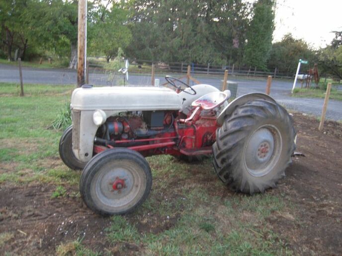

Dean, I have owned the tractor for 10 years. I am sure it is an 8N. Has the distributor on the side now in front. I thought it was a 52. Have looked throughly at sides of the gear box and have included pictures of the tractor, steering, and gear box. No screw above hood and below steering wheel.
Chris Looks like I wlll need to remove the dash and dash support. Certainly this was not the way Ford Motor Company originally designed the tractor to check the steering box and add oil. Very easy to locate the fill point on our 1953 ford jubilee. Any other ideas you have would be appreciated.
Chris

 Re: steering box fill plug on a ford 8N in reply to ejensen, 06-30-2020 18:43:08
Yes, it's definitely an 8N but does not appear to be a 52. Either a 51 or, perhaps, late 50.
A photo showing the upper lift arms would be determinative.
In any event, the fill plug is a bolt attaching the battery box (IIRC) on the right side to the steering gear.
Dean

 Re: steering box fill plug on a ford 8N in reply to Dean, 06-30-2020 19:09:13
Dean,
Sending a picture of the right hand battery box attaching bolt. Is this the bolt for adding oil to the gear box?
Chris
Dean,
Thanks for taking the time to help me with our 8N ford. Have sent a picture with a red line. Will check where the battery box attaches to the steering box tomorrow. Had the bolt out but was unable to get 90 wt into the steering box
Thanks,
Chris
