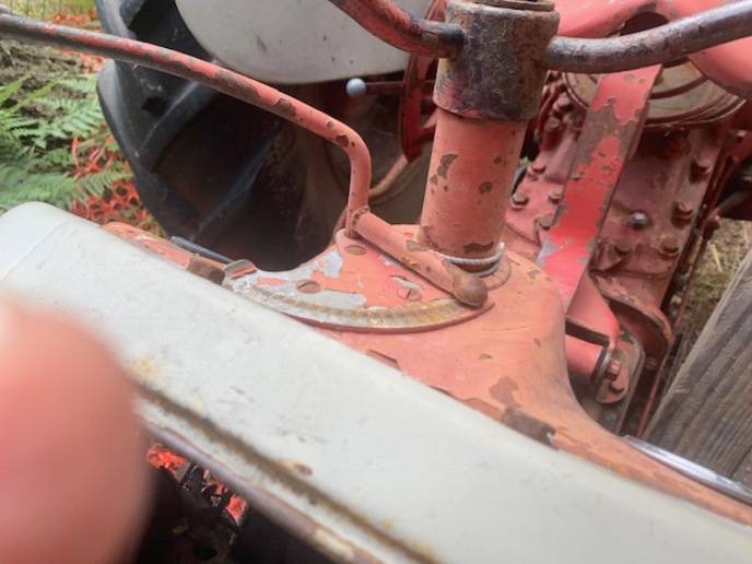

Where is the steering box fill plug located of a 1952 ford 8N? easy to see and use on my 1953 ford jubilee

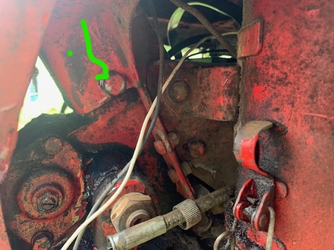

Btzj02
07-03-2020 05:58:54
Report to Moderator
 Re: steering box fill plug on a ford 8N in reply to ejensen, 06-29-2020 12:27:46
Quoting Removed, click Modern View to see
Lots of bolts. I was referring to the green line bolt! Let us know if you are successful!

Btzj02
07-02-2020 20:06:27
Report to Moderator
[quote="CVPost-ejensen"](quoted from post at 14:23:24 07/02/20) Hi Tim,
Including a picture of the bolt I think you removed to add oil to the geacase on an 8N. Put the tiny end of my quart { outboard lower unit style for addinging to the gearcase on an ouatboard} 80 90 wt just runs out the hole. is this the correct place to add oil?
That is correct bolt hole. I think it is Bruce, 75 tips, that recommends using a wire to find the hole. It is a slow process. I found the tube allows air to escape unlike just sticking the lube oil bottle nipple into the hole. I think I added a pint before it started to overflow. Takes a little effort to hold tube and squeeze bottle at the same time!
JB

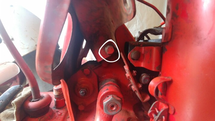

Soaked
07-02-2020 16:26:02
Report to Moderator
On later 8n right side behind the proofmeter.
The spare column is just sitting on the rear of the tractor for the pic. Oil flowes through the bolt hole following the blue line. It has to make a 90 deg bend into a smaller passage, before draining into the sump. I haven't tried filling recently, but would expect it to be a slow process.
John

Btzj02
07-02-2020 06:40:12
Report to Moderator
At the lake and cannot take a picture of my 51. If you use a plastic tube to fill I found it helpful to cut off about quarter inch of the bottom half of the end of the tube. That way you can push the tube all the way in the hole untill it bottoms out and the oil can still come out the bottom cut into the fill hole.
JB

Btzj02
06-30-2020 19:26:58
Report to Moderator
In any event, the fill plug is a bolt attaching the battery box (IIRC) on the right side to the steering gear.
Dean[/quote]
FYI After removing the bolt you cannot tell that it is where you add oil. I used a plastic tube to stick in the threaded bolt hole and attached the tube to the lube oil bottle nipple. Keep filling till it over flows!

Tim PloughNman Daley
07-02-2020 02:10:32
Report to Moderator
 Re: steering box fill plug on a ford 8N in reply to ejensen, 06-30-2020 20:33:22
Did you see my post with pictures below??? You show the air cleaner mounting bolt -NOT the lube bolt.

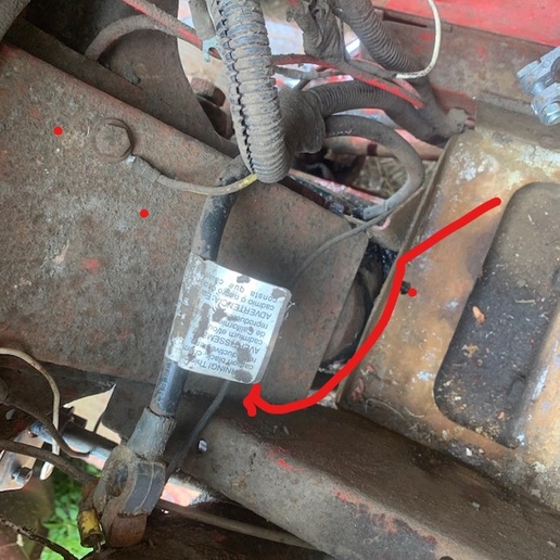

Dean
06-30-2020 19:09:13
Report to Moderator
 Re: steering box fill plug on a ford 8N in reply to ejensen, 06-30-2020 18:43:08
Yes, it's definitely an 8N but does not appear to be a 52. Either a 51 or, perhaps, late 50.
A photo showing the upper lift arms would be determinative.

ejensen
06-30-2020 19:29:26
Report to Moderator
 Re: steering box fill plug on a ford 8N in reply to Dean, 06-30-2020 19:09:13
Dean,
Thanks for taking the time to help me with our 8N ford. Have sent a picture with a red line. Will check where the battery box attaches to the steering box tomorrow. Had the bolt out but was unable to get 90 wt into the steering box

FORD 8N STEERING BOX LUBE PORTS:
- LATE STEERING BOX -
- 8N EARLY STEERING BOX -
TIM DALEY’S MODIFIED LUBE FITTINGS:
NOTE: Early Box uses ¼ NPT Pipe Plug; Late Box uses 7/16 hex bolt. Both I modified with a Zerk fitting to allow easier lube insertion. I use 00 Cornhead Grease
Tim Daley(MI)
