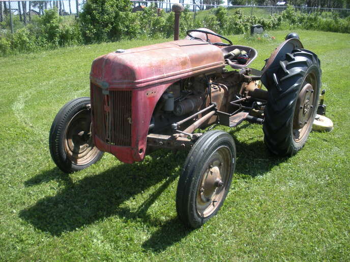

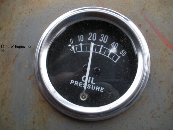

Here's my 2-N......
15-40....Engine Oil.....
Engine coolant runs at 180 deg F...Thermostat in top Rad hose...
First gear full throttle......
John Deere Grass Groomer...
Todays ambient 80 deg F
Tractor stored in shed for 30 + years
Tractor has ran prefect for the past three summers.....
North Western Alberta on the AB/BC Border....120 th parallel Longitude...
Bob....
My 9N has always had low oil pressure once it gets warm/hot (10 lbs). But it's been the same since I purchased the tractor in 1985. No knocks or bearing noises. I think the gauge is inaccurate.
