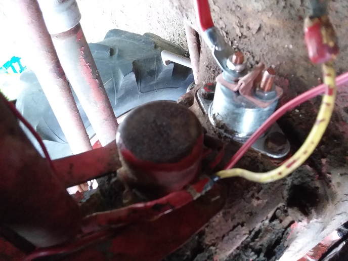

I need help.
I have an IT Shop Manual,I've scoured the internet. But, I can't seem to find , or really trust, what the real wiring for my 9N should be.
It had been altered over the years. It's a 6 Volt.
I got it up and running about 12 years ago. Ran for 2 years. It had sat for 16 years prior to that.
Gotta love those 9N's!! It ran like a top in 2008 to 2010 after I replaced plus, pounts, rotor, condenser, crab cap, and coil. And rebuilt the carb. It started quicker than my car.
Then it just started giving trouble. I let it sit due to life. Now, with new battery, new starter, points condenser, and rotor, and coil. Also a new switch. Barely turns over.
So, I've now put in a new ignition. Old one wasn't even in use. Oh.....
12 years ago.... because of how it was wired then... no ignition, just a wire straight from the Battery Positive, to the Coil. It ran great.
Back to now....
So, I decided to wire it right. With all new wires. Amp gauge is orig. And looks like it still works. Tested Resistor, seems ok. Cleaned them. Now, here's my question.
What is the proper way to wire it?
So many diagrams are different.
Also.... I've seen in some, there is a "Cutout Relay" in the Generator wire. Is that needed?
Some have a New Resistor " in line. Ugh....
I don't want to fry anything nor explode the battery.
I'm attaching a diagram of the one I have decided to go by. Is it right?
There are no lights nor light switch. So I'm ignoring that part.
Thanks in advance for any help.

LM1970
06-09-2020 13:15:24
Report to Moderator
 Re: 9N Wiring in reply to LM1970, 06-08-2020 18:10:41
Solenoid has 2 wires. Generator has 1. Placard appears to say 9N.
[Log in to Reply]  [No Email]
JMOR
06-09-2020 13:08:44
Report to Moderator
Quoting Removed, click Modern View to see
9N/2N start switch and cut-out
8N solenoid:
LM1970
06-09-2020 13:40:38
Report to Moderator
 Re: 9N Wiring in reply to JMOR, 06-09-2020 13:08:44
Thank you!!! It all makes more sense now! I assumed it was a solenoid. But, there isn't one I guess?

LM1970
06-09-2020 12:19:49
Report to Moderator
Ok... 1 picture at a time I guess.
The placard looks like it says 9N 98520
JMOR
06-09-2020 12:17:02
Report to Moderator
Front or Side
LM1970
06-09-2020 12:33:39
Report to Moderator
 Re: 9N Wiring in reply to JMOR, 06-09-2020 12:17:02
Front.
For some reason. My pictures aren't uploading.
2 wires on the Solenoid. 1 on Starter. 1 on Generator.
Placard looks like 9N 98520

LM1970
06-09-2020 11:48:04
Report to Moderator
Here are the pictures. I have some of the original wiring. But, well, I'll post those later if I need to.
It looks like the placard says 9N. There's a pic of that too.

LM1970
06-08-2020 18:56:40
Report to Moderator
What about the Cutout Relay it shows between the Resistor and the Generator. Mine doesn't have it. It's just a straight wire.
I also forgot about 2 wires on the solenoid. That's not on the diagram at all.
Where should those go?
R Geiger
06-08-2020 18:40:44
Report to Moderator
Go for it, that wiring diagram is what you need. no more no less.
Bruce(VA)
06-08-2020 18:38:32
Report to Moderator
the cutout opens when the engine is off to keep the battery from discharging.
the resistor is for your coil, not your battery. You have a 6v system with a front coil. all you need is the oem ballast resistor, per the diagram.
The diagram is fine. Use it. .
