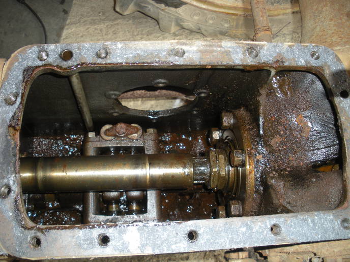

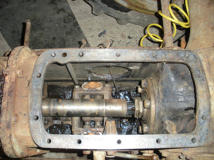

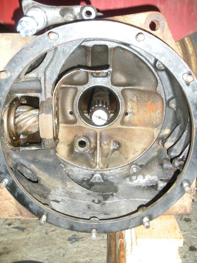

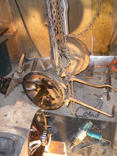

Good morning...……
After sitting outside 20 + years, did you notice the condition (visually)of the OIL in the Transmission, Hydraulics, Differential..as well as the Engine..???
1939 9-N ...is 80 years...
Last year I purchased a 1945 2-N from the original purchasing family. The Tractor had been in a shed and not ran for 30 + years. Oil was Nasty!
I was able to obtain a satisfactory cleaning with some disassembly...
All the best with your 9-N
