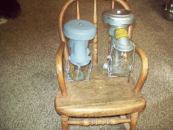

cyclone air cleaner jar and bail

 Re: What is this part? in reply to WW2N, 03-13-2019 22:04:25
Those are not CYCLONE models -they are the HARCO version and were not very effective.
