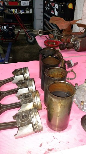

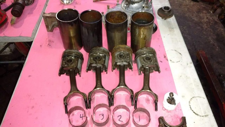

I have done some re search on the 134 , 172 , and the 192 Ford Industrial Engine . All three have the same stroke of 3.6 inches . All three use the same connecting rod part number . Same wrist pin . It would seem to me that a person could REMOVE the sleeves on a Ford Jubilee 134 and bore it to 4.13 inches and install 192 Ford Industrial Engine pistons . Does this sound plausible to you ? George in Harrison Ohio

OD of the 134 sleeve is just over 3.650 so you are talking about roughly .250 overbore in the block or .125 off the wall.

That would be a sleeve wall thickness of about .112 inch . Sounds about right . Leaving the sleeves out and boring to 4.13 inch might be a stretch . But I think it sounds like the 134 ** without the sleeves ** would be a bore size ( + - ) of 3.9 inches which is actually the stock bore size of a Ford 172 CID . So it may be an easy improvement to install 172 pistons in the 134 block without sleeves .

You seem to know pretty much . What is the outside diameter of the stock 134 sleeves ; or what is the wall thickness of the stock bore 134 sleeves . I can do the rest of the math myself . This is my son Nick's friend's project , and they live in Nashville TN . Last picture is Nick's 941 5 speed with a 172 CID 62.6 HP engine .
