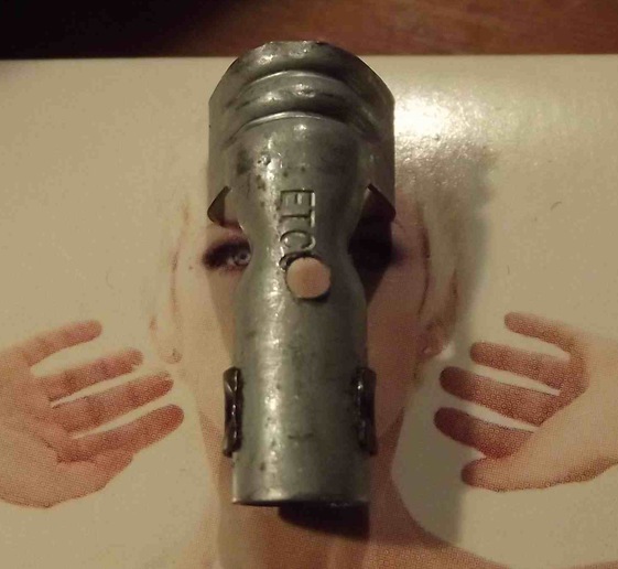

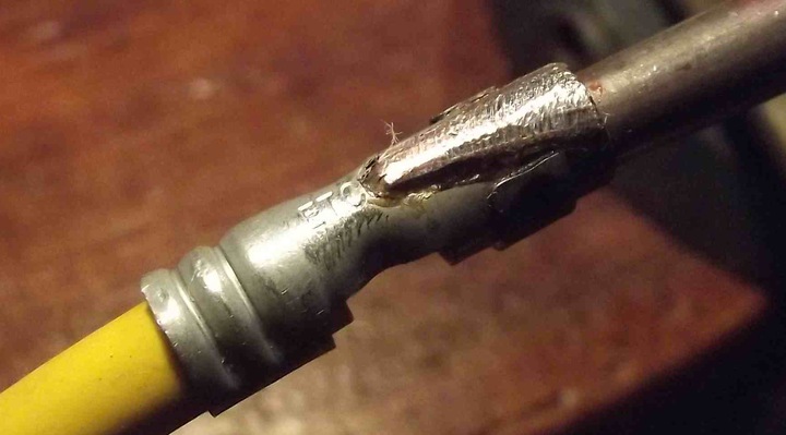

I built a copper cored wire set using liquid solder i got from a rad shop and a small propane flame. I brought the yellow wire into the crimping zone but then ran the length of bare wire up through a hole in the fitting and splayed it out over the back of the fitting and even a little folded over the open end if the wire was too long. The angled cap ends already had the holes but for the plug ends I drilled the holes.
Anyway . . . with the soldering, the crimping doesn't have to be technically perfect anyway so just improvise. Obviously I had a long punch in a vise to hold them for soldering.
PLUG END
PLUG END HOLE
DIST CAP END
